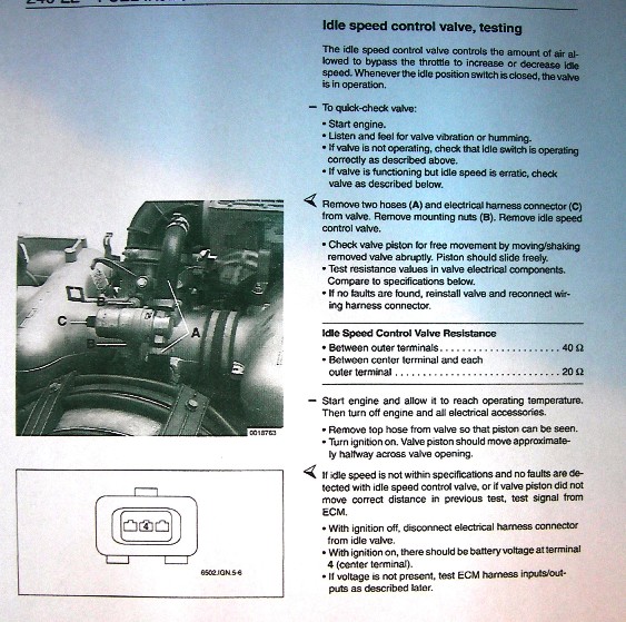

Did you ever get the electrical test info from Nessie ?
No, not as yet although I must admit I'm beginning to wonder whether it is a characteristic as opposed to a fault as some road tests that were written in the eighties seemed to pick up on the stalling when cold. We'll see.
Chris
I think this is the Bentley procedure.
Any recommendations for a good ohmmeter ?
