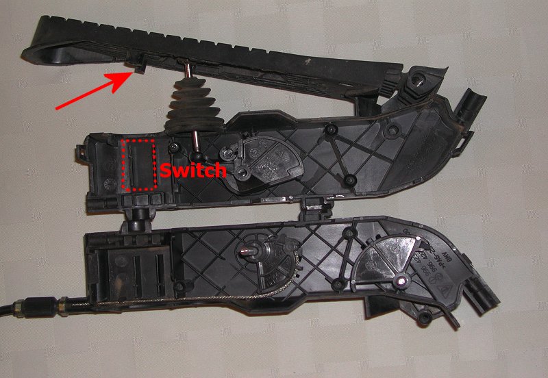

There is a dimple on the underside of the pedal which presses directly onto a switch in the pedal housing. This is a pedal from a manual, but you can see the dimple on the pedal, and I have marked where the switch is located:
Thanks Richard, I'm begining to wonder if it wasn't the throttle mechanism that had become detached, going for another test drive on monday and will take a closer look.
