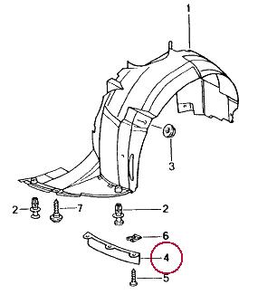

Hi does anyone know whot the small plastic things are called that are mounted on the underside of the front wings infront of the wheels,mine have broke and i want to replace them,also were i can get them online.

Not sure about online.. and there are more than one bit of plastic each side - di you mean the flaps, or the cone shaped bit?

Part numbers are 996 504 503 00 and 996 504 504 00 according to side. I called them mini spoilers/deflectors when I bought mine. I confirm that they are not very expensive. To avoid replacing them on a regular basis, I cut 1 cm. off of the new ones as I was touching everywhere.

If you mean the vertical flaps, be aware they ARE part of the aerodynamics, and people have reported large variations to the handling when they are worn/broken - when compared to new ones.
There called a "Rubber Lip" on PET, and are only £8.84 each (inc VAT).
I must replace mine, as you say it affects the aerodynamics at speed.

Thanks for the info. Bluebox as shown exactly the part. In the Porsche workshop they are called "cover left and right" with combination screws B4.8 x 19.
