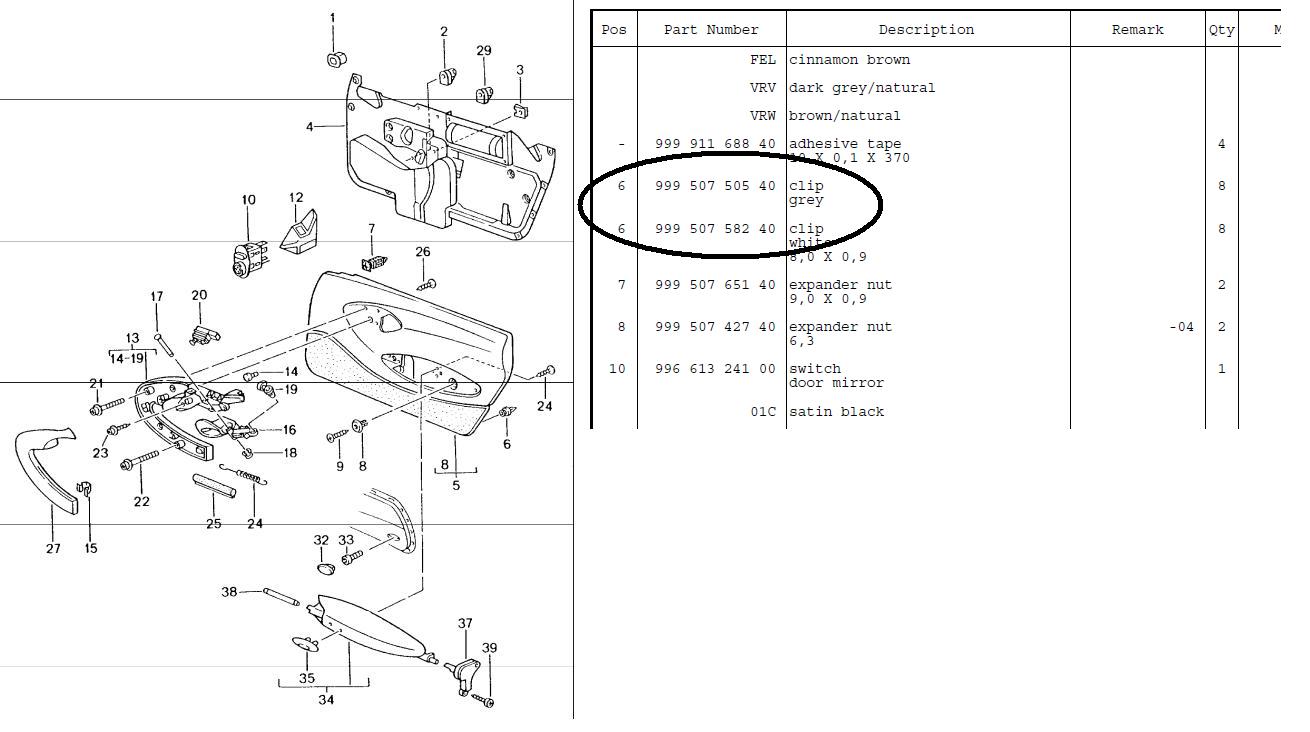

Hi guys, i removed my both front windows to give them a clean and when i replaced the door card i noticed that a couple of those plastic clips were broken. Ill attach a picture but the one thats gone on both door cards is the first one under the wing mirror. In the picture there are 2 part numbers for the plastic clips which i think are number 6.
The clips numbered 6 are the ones which go around the edge of the door card. There are two types - one is a little longer than the other. The idea is that you choose the clip which gives the best fit. If you fit a short clip, and it doesn't hold in the door properly, replace it with a longer one.
