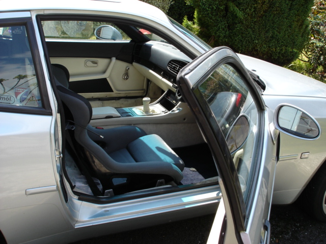

After a lengthy period fixing my 944, its finally on the road. As this is the first time I have driven it, there is a few things needed to get it going properly.
These are things like gear shift linkage, exhaust leaking, various rattles etc - but my biggest bug bear just now is the win noise from the front doors.

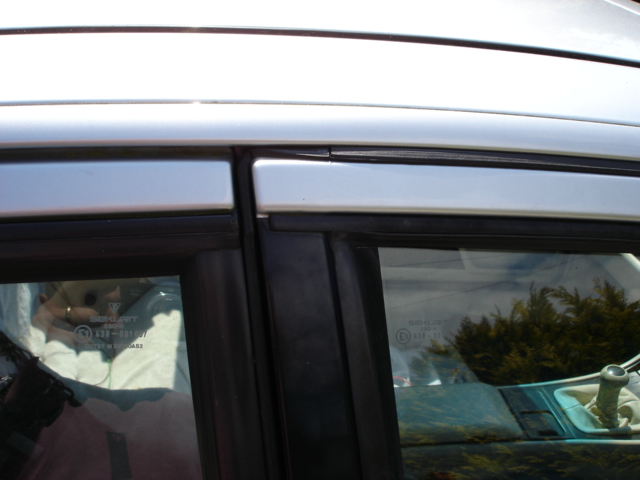

There appears to be big gaps on both front doors, up around the glass between the door and the B pillar. the are folds in the metal of the body and the door, about halfway up the B pillar, and about 4 inches long.
What are these for, and how can they be sealed? they seem to be ideally situated to provide the maximum noise just to the right of my ear.
If I understand you correctly you're missing a door rubber:
OK, if i see that photos right, there should be a second seal, fitted to the doors, not the car frame, running in the square groove around the very outer edge of the door?
checking mine, there could be marks where this was once stuck in there?
