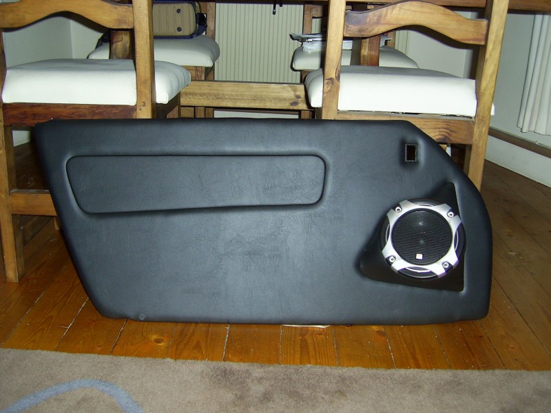

I made my own complete door panels for the car but decided to keep the arm rest pockets but re designed the rest how i wanted it. Look really good all built on the car. Covered in a heavy duty black vinyl with slight pattern, all new window switch surrounds to. These surrounds came from forrest fine so they may do the bits you want and are very well priced
