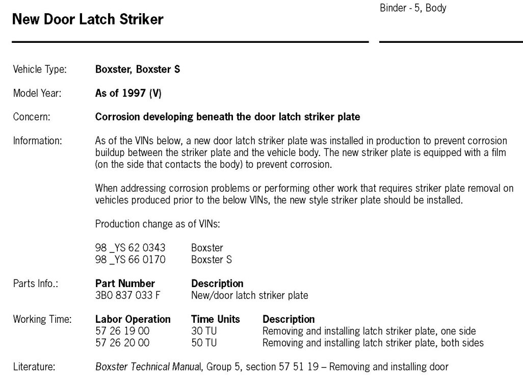

Probably being overcautious, but I want to fit the "gasket" mentioned in many Porsche forums to avoid any rust forming behind the door latch. I asked at OPC but they looked at me as if I had made it up ! Someone please tell me the part number ! [:(]

Looking at the TSB, you have to replace the latch striker complete - there is no separate gasket listed. John has given you the cost effective option, but here are the details if you want them:
