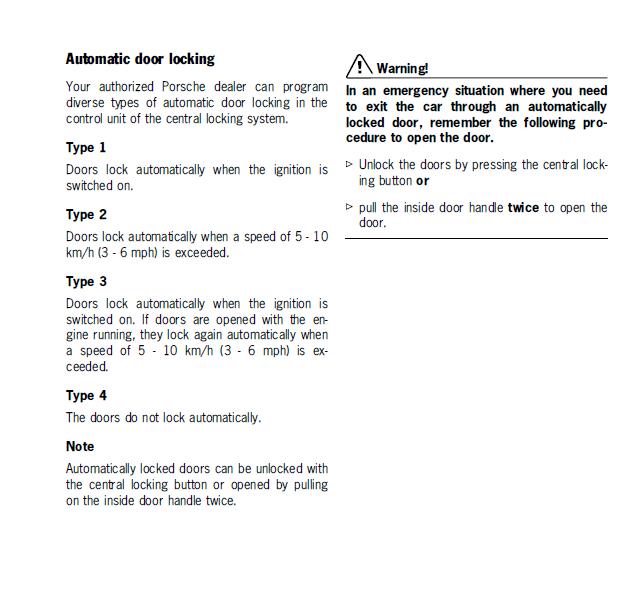

Do you have the owners manual?
If not here's a snippet that may help:
hi again thanks for all your replies you have been a great help i have now got it sorted the doors now lock how thay should do when i exceed 5 mph its a lot better now thanks every one
it just needed to be reprogrammed differantly to what it was set at he told me that there is a few settings that you can set it at but thanks for your help
