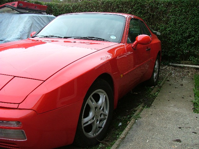

got it in one, i wanted somethig a bit different and there aren't many cars with door mounted mirrors nowdays and these are all i could find with the right door angle. i quite like them over the originals.
Well, they may be back in force, as a relatively recent EU legislation has apparently now made compulsory mirrors mounted on the doors to improve visibility. Might have been motivated by A-pillars getting ever thicker.
They look pretty good actually. I've been trying to work out if MX5 ones would work but never got round to doing anything about it.
Can't see on the photos: have you kept the original bases or used the mini ones? Any mods required to the doors if you have used the mini ones?

used the mini bases and they have nice rubber gaskets too, no mods to the door but a few mods to the mirrors. the mirrors look bigger in the pics than in the flesh.
I think they look ok, similar to 968 mirrors. If you could find a way perhaps to shorten the base they`d look great.
I`ll have to say (as a non member [;)]) I think flag mirrors date the cars somewhat and teardroptype mirrors look great from the front sort of streamlining the car in my view.

I have a set as well that are waiting to go on, I think they are no bigger than cups though the bases are longer, was also considering last shaped mr2, audi tt, hyundai coupe, but the mini ones arrived at the right price.
I think the lack of depth in that picture makes them look more chunky than they are,
