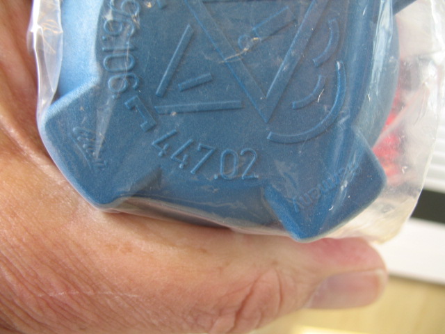

Porsche has come out with yet another cap with a part number that ends in .02, but the part number on the bag it comes in ends in .01.
had my car serviced today at pc cardiff when i booked the car in i ordered the cap,picked car up today, also had the cap, it also ends in 02.
