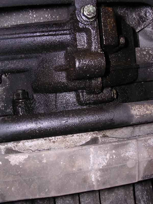

Chris,
If you do get underneath this is what it will look like at the join of the engine and gearbox.
RB
