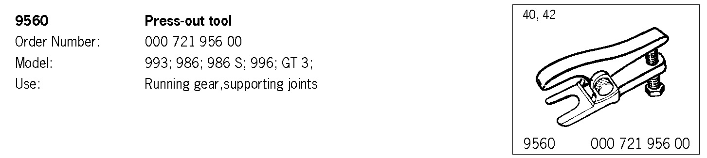

Pre MOT inspection yeterday shows offside outer boot split. To remove drive shaft requires 32mm socket, T40 Torx "screwdriver" and Porsche tool 9560 ball joint press to undo the control and track arms and an 8mm stud socket for the drive shaft cap bolts.
Q1: Anyone know what's so special about this press or will a propriety ball joint splitter using a threaded stud on a lever do? I have some old type splitters you hammer into the joint but always thought them a bit brutal and prone to damaging any rubbers present.

The special tool is just a proprietory ball joint splitter - personally I wouldn't use a forked joint splitter as you are likely to damage the ball joint rubbers. The boot rubbers are available from Porsche at about £23 each (ouch!). You could also try eurocarparts.com.

I will buy a joint splitter like the one in your attachment, they are commonly available and as you say do less damage than the old fork type and heavy hammer(ouch!).
