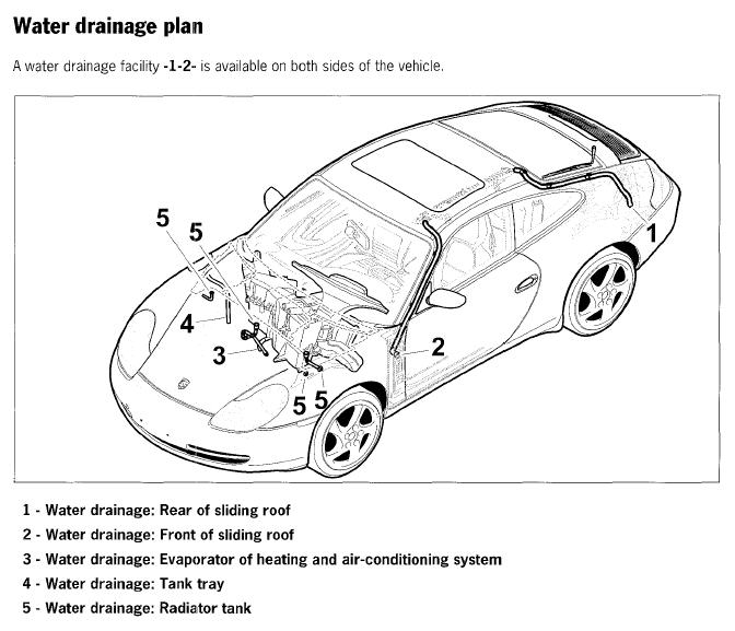

does the car have a sun roof ? when i first got my car the electrics were playing up and this was traced to the sunroof drain tube having a hole in it leaking water onto the back of the fuse box took a while to find as my carpet was not wet and they expected it to be if the drain was leaking or blocked

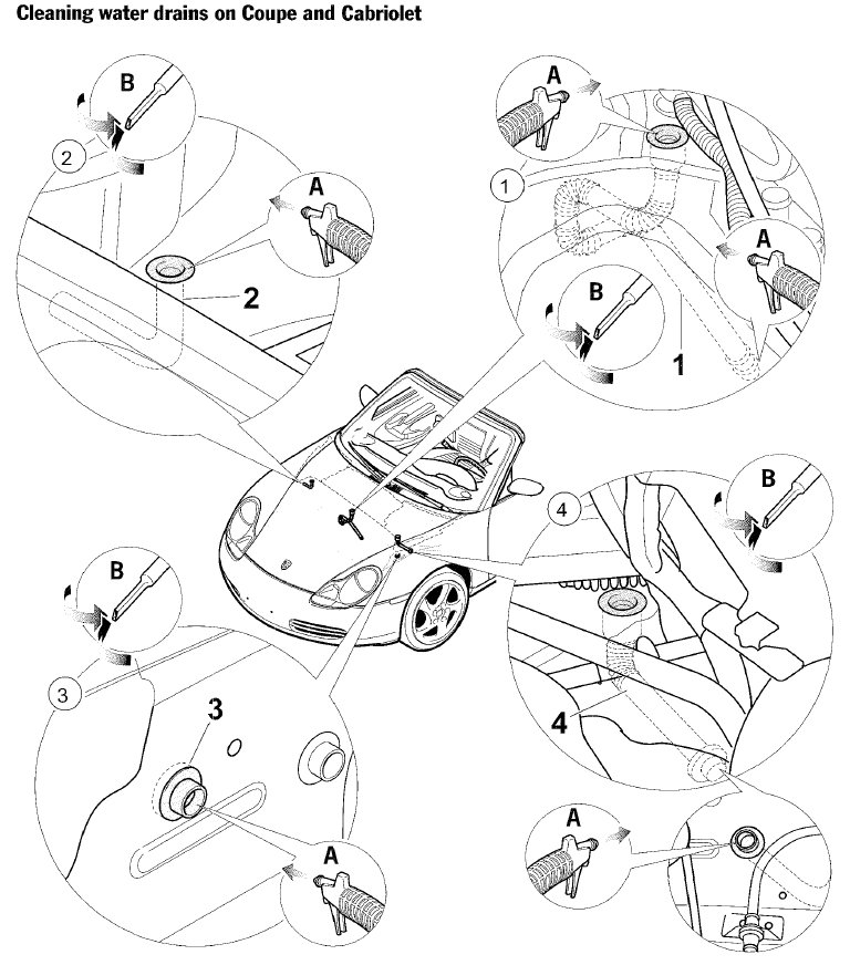

It could be a ruptured door membrane, or the front drains (either side of the battery) are blocked.
If you take off the covers either side of the battery (1 x T20 Torx screw) and find a pool of water in there, that will be the problem. The manual suggests a vacuum cleaner or air gun to clear the debris.
