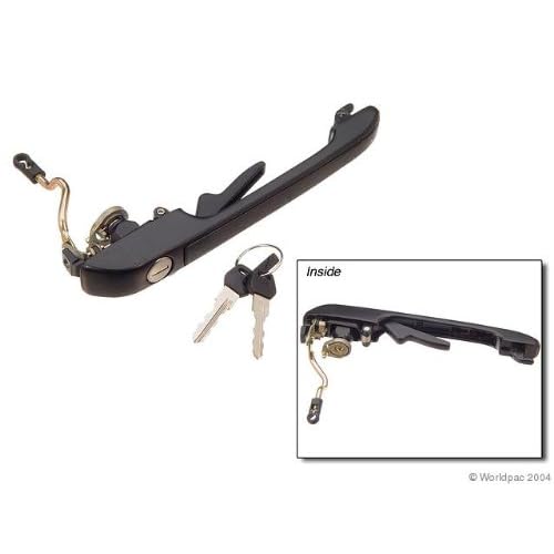

Plastic ball joint popped off or snapped possibly
The handles can get gunked up with dirt which can also cause this problem (have had it on mine). Before attempting anything that involves any sort of dismantling, try giving it a good old squirt with WD40 and giving it a wiggle. May not be this but worth a try.
If you do need to start removing things then there is a great guide on door handles on the Clarks Garage site, just go to http://www.clarks-garage.com/ then Garage Shop Manual and look under D for Door handle removal - step by step photos. Good luck
They do break the main casting on one of the pivots which is a pain to see without a strip down.
But as has been said the most common problem is just gunmmed up!
