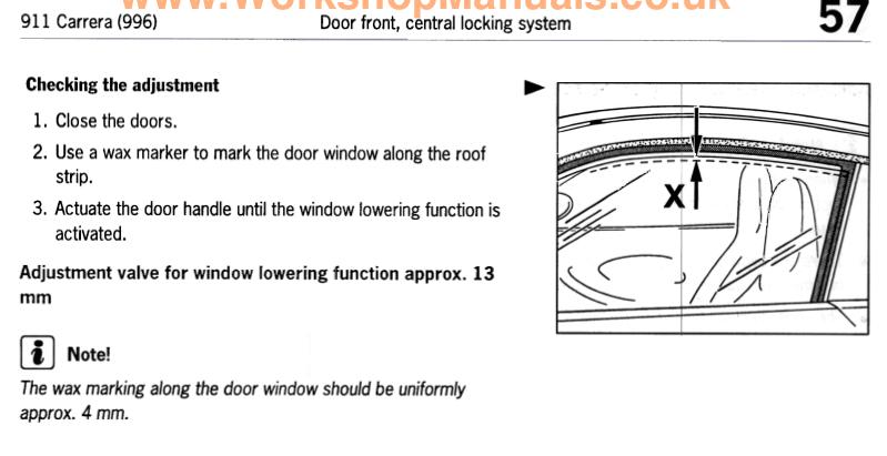

Tks for your responses. The window does work smoothly all the way up. The window is trying to lower itself when the door handle is pulled but it only achieves about half the normal distance, which is barely enough to clear the door seal. I've just been looking at the workshop manual and it refers to an adjustment valve - "Adjustment valve for window lowering function approx. 13mm". Do you know where this valve is?
Defo says valve...
That's a very old manual, but it is a typo they have carried forward to much later versions.
Is it the plastic screw in the door pocket they missed out? Seems to catch most people out.
It's not at all obvious that screw's there in the workshop manual I have. They refer to a compression screw, which may or may not be it. If you peer closely at the picture the plastic screw is shown but I missed it the first time I tried to remove the panel.
I took the car to the garage but the central locking was working, typically. They connected it to the ECU and looked in the log but it was full of alarms linked to the central locking and window failing - too many to know what was the root cause. The feeling is that it's the driver's door lock though. While it was there they lowered the height of the driver's window and that seems to have fixed that issue.
