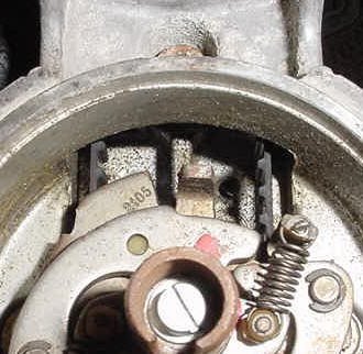

Have you checked the distributor drive belt this would give a bit of an off feeling if it had snapped ?
More info at Johns http://www.porsche964.co.uk/ technical / Engine & Transmission / Broken Distributor Belts
As Kevin states, if the battery is disconnected, wait a while, reconnect and then go for a spirited drive to reset the DME.
try that first and if it doesnt sort it out id certainly recommend checking the dissie drive belt as (not trying to worry you) it is said that it 'could' do damage to the engine as you are only using 6 spark plugs instead of 12 and one of the rotor arms will be fixed at the stopped position and sparking all the time at the same contact as the secondary dissie is obviously driven by the belt
A pic of a dissie drive belt.
More details at the link i gave you above
