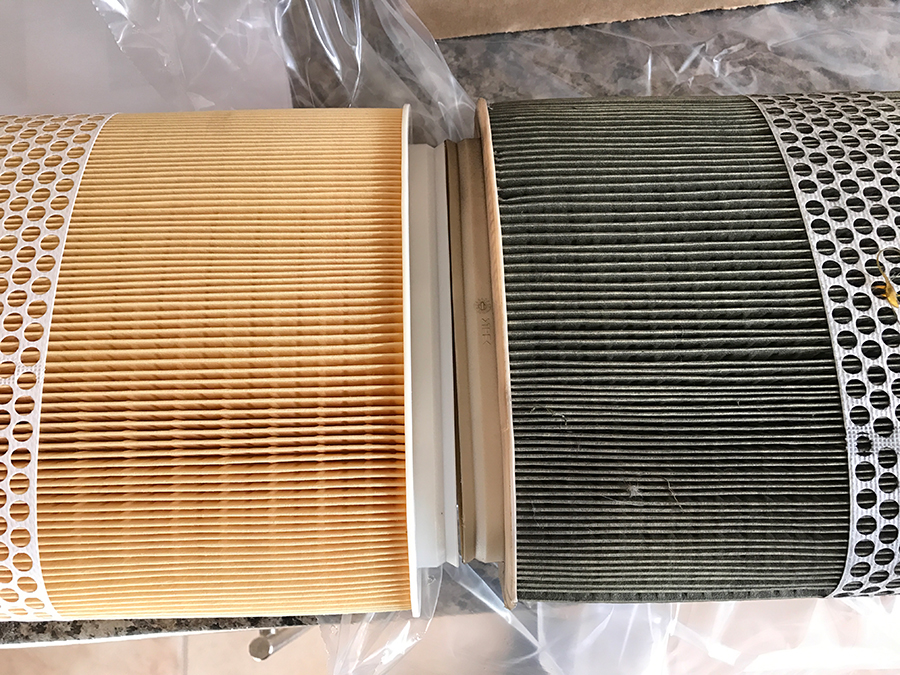

its shocking, I just changed mine also, I must have gained 40bhp in the R it even pops and burbles a little now:)
A new cotton filter flows more than K&N , the issue is cotton flows much less once clogged up so to keep bhp I think a change every year is worth while.
6 years for an air filter is shocking imo it should be at least done on the 4 year major !.
cars were done once a year when I was growing up.
this is after 25k miles, fully clogged , and they say ok till 60k lol

A periodic check of the discolouration as shown in Mr D's photo is easy enough and that it is six years or 60K miles is ridiculous, I have seen paper filters which are clean in appearance after years in use and others clogged with dust or oil and other contamination which have done little but the owner asked me to take a look as his car was using a lot of fuel! Unlikely to effect any of our cars but some out there are not at all sympathetic to their vehicles. in a car which covers most of it's mileage cruising on a motorway and out in the country while six years may be acceptable to Porsche less would be preferable and for one used on track regularly, maybe the beginning of the trackday season.
