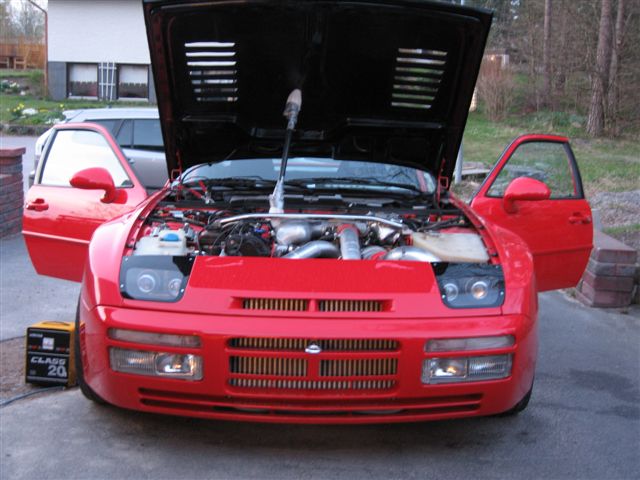

Well it's actually a Swedish guy known as Corleone on Rennlist. His car is VERY nice and stonkingly quick. It has 625whp at 1.25 bar on E85! That's pretty handy on relatively low boost. ST would have used considerably more boost and race fuel on a US dyno although Corleone's car is 3.0ltr. I suppose that a good way of determining the power of our cars around the world is something like this 100-200kmh test as there is nothing to it but mash the pedal. We should start something like this in tandem with all the dyno figure lists that are not exactly apples to apples. Once I get my car back I might just do that...and try not to get arrested.[&:]

Does the magic wand holding the bonnet open have anything to do with the performance? [;)]
Tony

Tony, I was wondering when someone would point that out. [;)]
