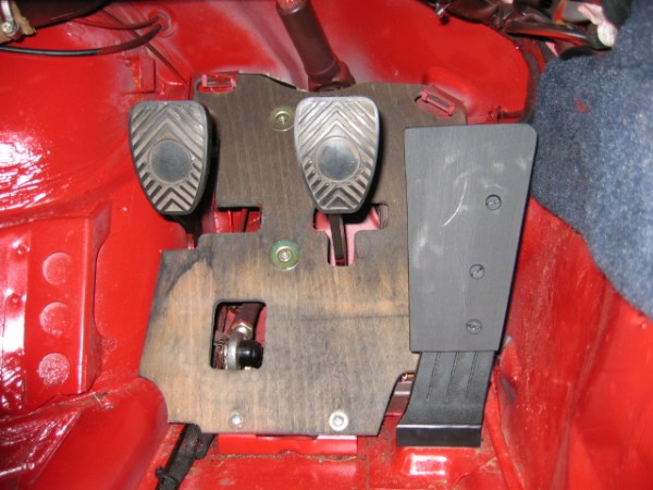

yes easy 2 nuts, i posted pics a while back, simply bolted on a piece of wood to suit.........
Did the same thing on my old 964 - bolted on a suitably thick piece of wood - actually used a piece of an Ikea kitchen wooden worktop, cut to shape and sprayed black. This worked perfectly and allowed perfect heel/toe gear changes.

Thanks for all the advice. I managed to remove the pedal eventually and bolted on an alloy OMP plate bought for £12 from Demon Tweekes. Refitting it took seconds.
I was worried it mike look a bit chav but actually doesn't look too bad. (will try and take a pic)
The result is I can now actually heel and toe for the first time since selling my Elise. Yay.
Bit rusty though....
here's the plate if anybody is interested.
I only used the big one on the accelerator so the brake and clutch pedals remain standard.
