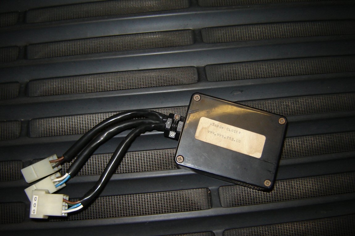

Hi
The 'black box', and that is exactly what it is, a plastic project box approx 4x2x1 inch, is in the front boot (under the bonnet) behind the bulkhead cover (with all the other wires etc) Mine was on the drivers side
I has 3 cables coming out of it (of 4 wires each if I remember correctly), with three plugs , one to each of the window switches, and another that I cannot remember from where.
Mine has a paper adhesive sticker on it with the part number (as per the original post).
I will endevour to get some photos and post them here.
Hope this helps
Anthony

Some pictures of the box

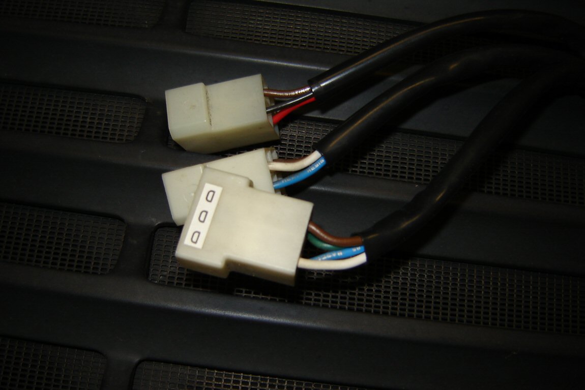

...and these are the 3 cables with connectors. You'll see I labelled the two windows connections D and P (driver and passenger).
To test if this box is the problem, I swapped the driver and passenger around.
