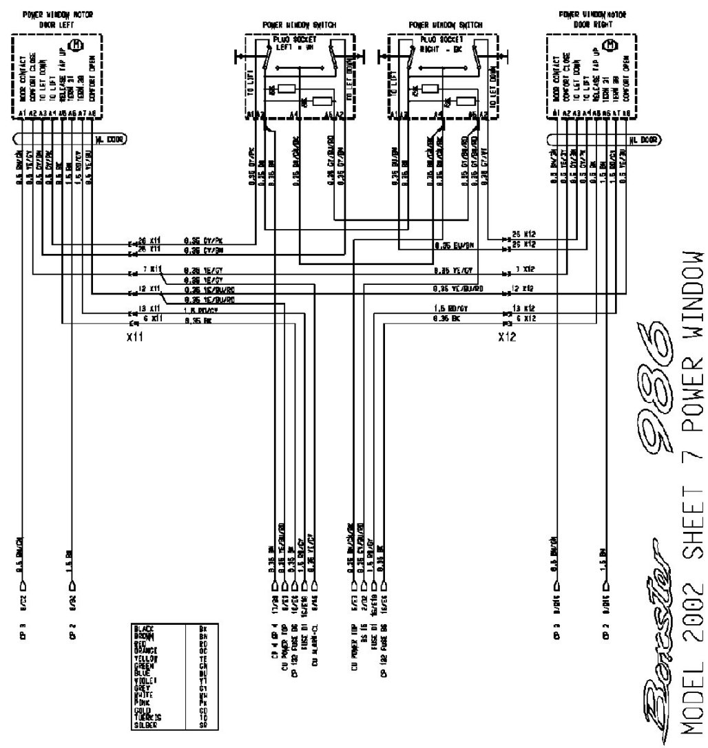

Model Year?? The attached is the best I can do given the limitations of the forum software (200kb attachments). If you want the full diagram, send me an email with the model year and I'll attach a pdf to the reply. Also, a description of the problem would help.
Cheers for that Richard. Sorry I can't give any more info at the moment - apparently there is some kind of noise coming from the door but that is all I know 'till I get there [8|] The diagram should give me a starting point anyway [:)]
I'll have a look and post again with the results!
