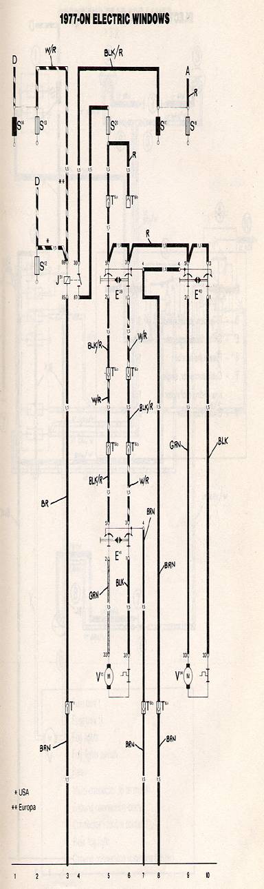

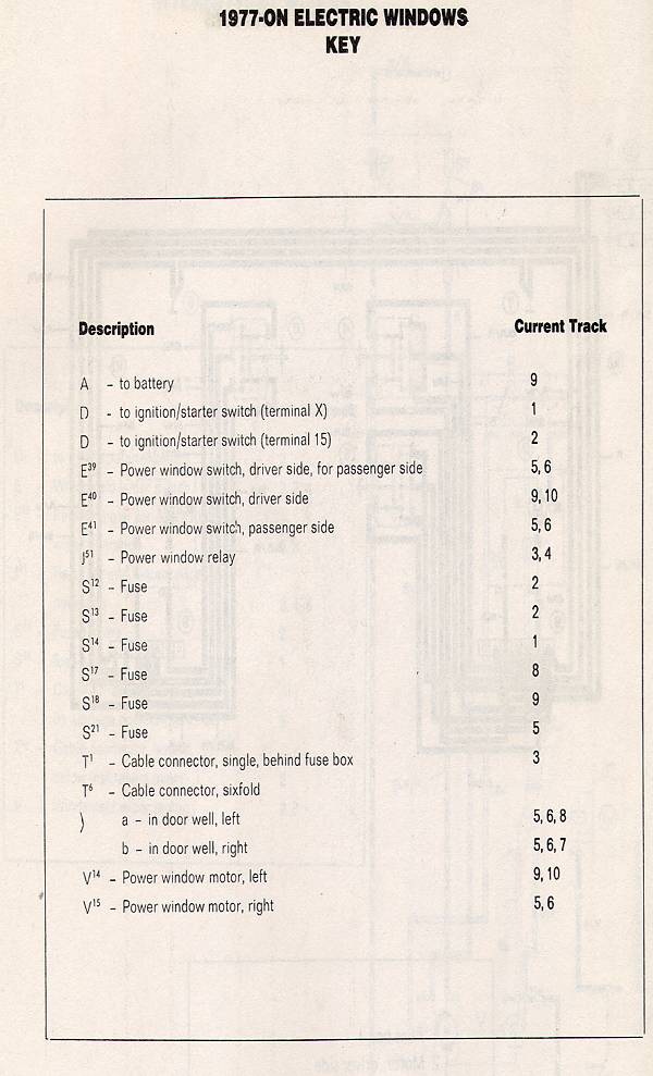

James you didn't mention whether or not you had checked the window relay. If this doesn't solve your problem then you will have to start taking the doors apart and testing components, I bet it's the relay.
Many thanks,
Any idea where that relay is? There are three relay's with the main fuse board and a couple in the engine bay (fuse board III? I think).
James.
