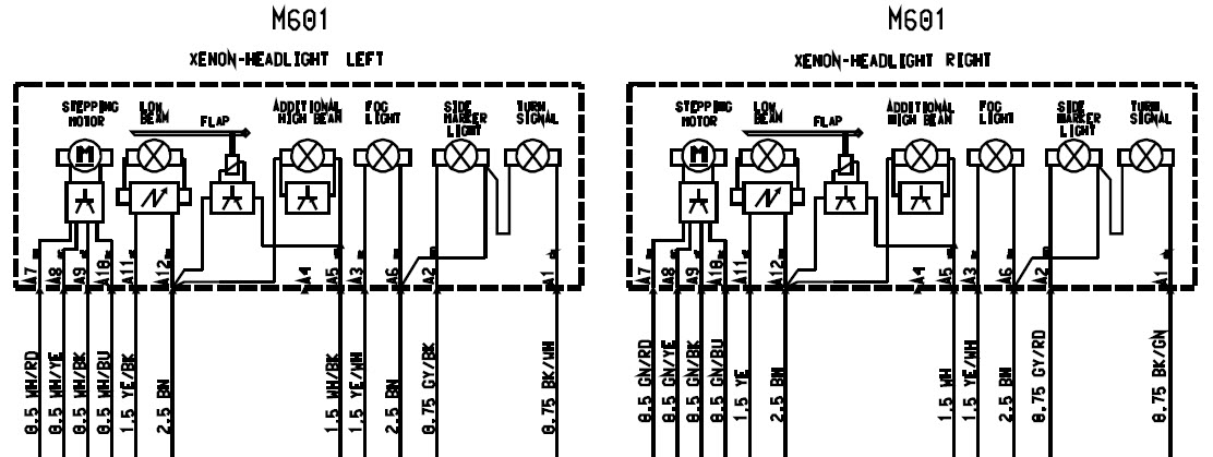

Im looking to find a switched live wire i can tap into and the positive wire colour of the main beams on my 996 Turbo.
I need the switched live to be in the luggage area, Ive read that the heated washer jet wires is the only switched live in this area, can any one tell me what colour wire is the live ??, i believe its between the yellow and the brown??
I also need to know which of the wires to the head light connector block is the main beam positive wire??
The reason im asking is because im going to install some DRL lights and need to tap into the switched live and positive main beam for the relay to work.
Yes, the washer heaters are about the only option. The Brown is earth. Brown is always earth on a 996.
I'll look up the headlamp connector pin connections in the morning, when I get to my PC. What model year? I assume they are Bi-Xenon.
Here you go:
ORIGINAL: pje1210
