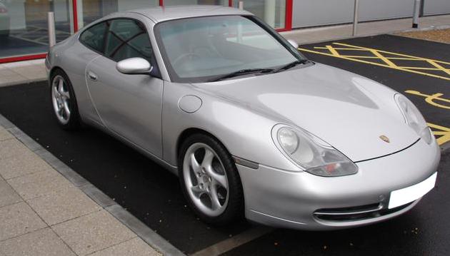

I have now bought the one below and fingers crossed it seems a good'en. [:)], look forward to joining in with any 996 festivities.
