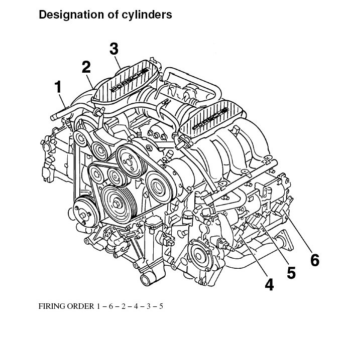

Hi Guys,
I have a bit of a newbie question - Does anyone know the numbering sequence of the cylinders on a '99 3.2s.
I need to replace coil packs 1 & 3.
Here you go:
