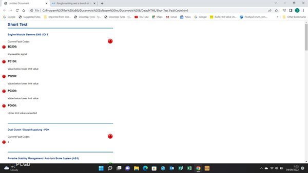

had the dreaded engine light come on yesterday. 2015 981 Boxster.
Plugged it into my Durametric and got 5 dtc’s come up on engine module.
P0100 - Maf Sensor
P0200 - Fuel Injector
P0300 - Multiple cylinder missfire
P0000 - No Dtc’s detected ?
The engine misfires at very low revs only, such as pulling off forward or reversing.
I performed an actual engine module test and observed the values for each cylinder. Cylinder 1 values were different to 5-6 which were all the same.
My thought was possible coil pack playing up but does anyone else have any ideas please?

I suspect it’s a similar problem to yours was. Just wish the Durametric results were more specific.

Clearly Durametric has its limitations John, as you would expect from a basic diagnostic tool. Unfortunately you’re going to need PIWIS or its equivalent to gain more detailed information.

did those codes all come back after you cleared them ? You could be looking at historic codes.
if you have a difference between cyl 1 and the others that is reproducible then suggest swapping Coil packs betweeb 1 and another cylinder. if the fault moves it’s coilpack.
