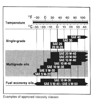

and I always post this from the handbook, [:D]
