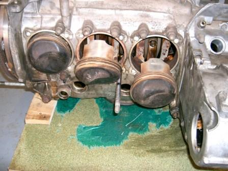

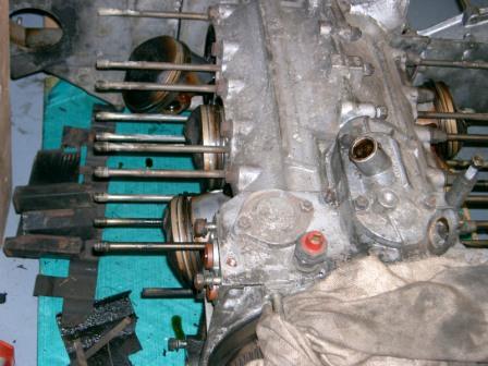

Hi Bones,
I did all the work with the engine on the trolley (I didn't seperate the crank case). It was the head studs on the exhaust side that I meant. Even with the engine down to the crank case I couldn't get the studs out. I took the whole lot to a local Aston Martin specialist who warmed the whole crank case by putting it in a box and blasting with a gas powered space heater, then removed the studs with a stud extractor. It took them several go's! I did at least replace all the studs. See photos.
Thanks for posting the pics Paul always nice to see what pweople get up to in their spare time! [:D] Those studs can be a real swine to get out out even with real serious heat, Chris Turner roasted one of my exhaust studs for about ten mins and the bugger still wouldn't shift in the end it was drilled out and time-certed.
The last one I rebuilt had three bottom studs sheared off level with the crankcase (well a little spike sticking up like a stump was all that remained on one). I dropped the cases off with CES Power Ltd in Buckingham and they did a sterling job of spark eroding the bits out of the cases.
My recommendation when fitting new bolts is to use the later versions as fitted to the 993 engines. You can easily tell these from the earlier type - gloss black with thread running the length of the bolt. Apparently these are made from a different material and are not prone to failure.
early studs will do the job just as well but whatever you use avoid dilavar studs, fitted as standard.
