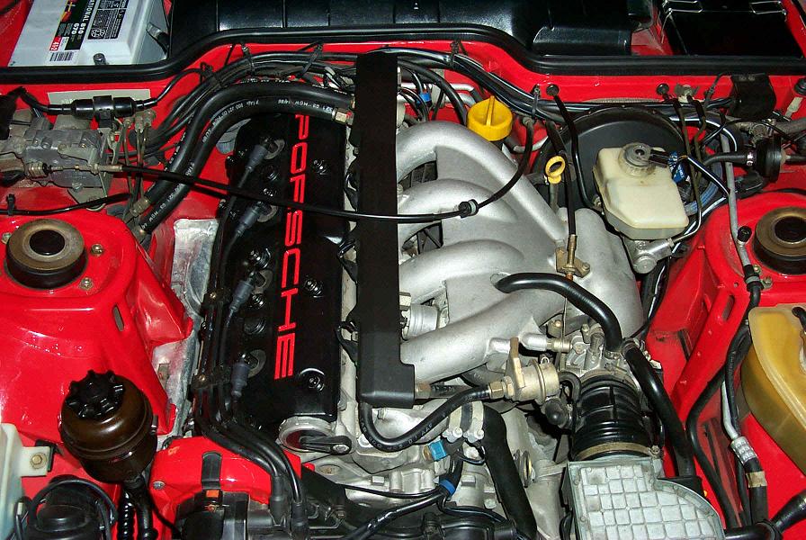

Because beige is ugly.(see pic.)
Lets have some engine pics. and how it was done as not to go off thread[;)]
I polished the aluminium rocker cover by hand and then painted the indented porsche script red, giving the whole thing a final coat of clearcoat. Didn't take too long but there can be some major casting imperfections which take a while to 'iron out'.
Not sure if I like it as it comes out like mirror chrome, which I have never been a massive fan of. Which makes me wonder why I did it.... possibly filling time while waiting for parts to arrive, and it was less damaging than polishing the paint off the bodywork in frustration.....
I also painted the manifold again using normal automotive paint from Scally-frauds. Some Fiat colour was a pretty near match

is it likely to be camcoat or similar or am i way off the mark there?
I saw a 928 a few weeks ago with its twin cam (or should that be quad cam?) rocker covers painted titanium metallic with red script. It did look very good.
To be entirely accurate only one cam cover had been done at that stage but you got a great before and after look which better demonstrated how good the painted one looked.
