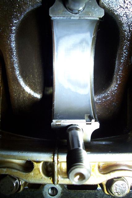

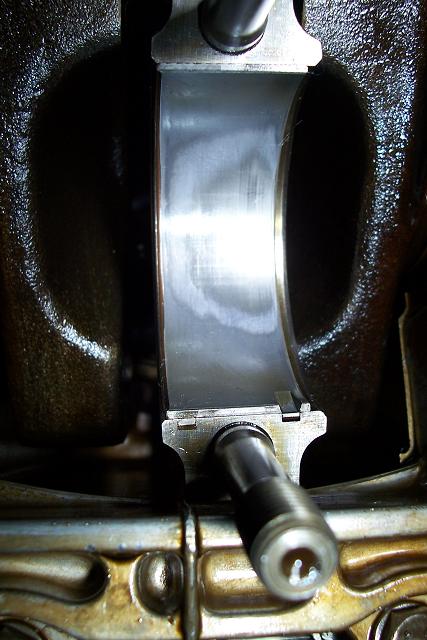

The engine on my 944 T has been making a knocking sound for the last 10 miles or so . I feared the worst and laid it up and did a sorn ! I thought it was time to bite the bullet and have a look at the bottom end , so set about some extreme D.I.Y after having been qouted £2500 to have the shelfs replaced and stuff ! Ouch !! After two days of removing parts I finally got the engine sump off ! I am not to clued up on engine wear or rebuild , So don't know what to look for really just having a go . I can not see anything obvious or see anything broken as such ! Only thing that stands out is on piston 2 the conrod moves a lot side to side on the crank ! Could this be the knocking I have been hearing ? I took the bottom part of the conrod and removed the conrod from the crank , it seems to have excessive wear on one side , to the point that the shelf is rubbing against the crank if you know what I mean ? I am no expert but fear the worst and that I may need an engine rebuild or a replacement engine ? Please can anyone help and advise what to do with the engine next ? Thank you

That looks like why the engine was knocking. Check the other 3 and the crank for wear. If you replace all shells and bolts all should be well.
As you have got to that stage it's worth pulling pistons and checking rings and bores for wear and also the little ends.
I've seen a lot worse on running engines, looks like you just got them in time!
So is the side to side movement on the crank due to the shells ? I thought the conrod was worn on the side to the point were the shell is rubbing against the side of the crank ?

This picture explains my concerns of uneven wear on each side of the conrod click on thumbnail to enlarge and I have circled areas .

The crank does not move side to side , it is the conrod that moves side to side excessively on the crank , so were the two nuts are that hold the conrod to the crank , you can move it side to side with your hand about 2-3mm , now the other ones barely move 1mm if that .
It might be the big end bearings knocking so doing the shells might be of no prevail and trust me this is not a small job ! So i was just seeing it anyone had previous experience and could steer me in the right direction .

THe conrods will move side to side at the top thats normal, there is a 3mm approx gap either side of the end of the top of the rod.

The bearing in your picture is not particularly worn, certainly not enough to cause a knocking noise. If it was you would be seeing a pure copper colour showing through the this skin of aluminium. This is how they are designed.
