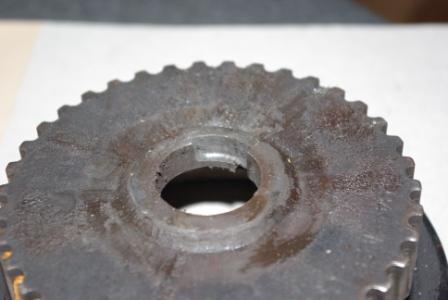

My engine was sounding terrible (and leaking oil and had oil in the water) is I swapped it. When i took it out I noticed that the bottom pulley was loose. The bottom balance belt pulley has a key which on mine was really worn. The keyway in the pulley is a strange shape or mine has worn a much larger groove!
