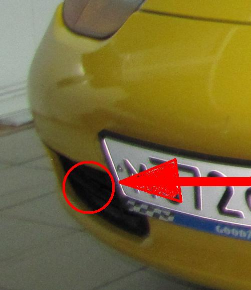

Good day. I have question. I have changed antifreeze. and checked up thermostats. I suspect that fans incorrectly work. I know that it have 2 speed. Who knows how to check up it? What it is the gage?(see the picture)

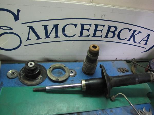

I want to rebuild fuel filter and rear shocks. And after it I show the pic. But i need 5 days. Because i wait shocks.
The sensor arrowed in your first picture is the outside temperature gauge, to display ambient temperature in the instrument cluster. Has nothing to do with engine/coolant temperature.
