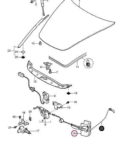

Thank you to everybody for your prompt replies and advice except I have a real problem now! I had left the bonnet a jar last weekend with a view to changing the battery over today after all your advice. When I went to my garage this afternoon the bonnet had somehow shut! NIGHTMARE! I have tried to open the bonnet again via the fuse box in the footwell but have had no luck whatsoever. I need to get the battery out so I can replace it. Please can anyone advise and also does anyone know of a specialist Porsche garage within the Watford area? As this is probably the route I will now have to take unless one of you guys and girls can come up with an answer. Once again thanks to you all. Cheers Jules.

The PET shows the emergency cable release, the same as the 986 had. You will need to remove the wheel arch liner and fiddle around near the back of the headlight to find the cable and give it a tug. It shows on the passenger side - item 22:
