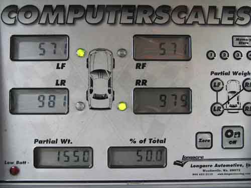

as I always concentrated on corner balance
U have the kit / proceedure for this ? - I've had mine balanced, but never seen it done, and didn't know what they use... perhaps a "talk your weight" machine from Woolies, won't cut the mustard..[;)]

Found a good link on the Pelican about corner weights...(see picture) Have you have experience of how (example) JZ / Autofarm / etc do this ?
Yes, they have electronic scales for each corner and little ramps to drive up on. The scales have to be on level ground and you should add a person or some weight in the drivers seat. The read out shows each corner or diagonal cross weights or whatever scales are capable of. You measure once then make a little change - normally using the front adjusters as they are easy - then drive the car round the block so it settles and back on the scales for another measurement. It is an iterative process.
Piccy will give you the general idea. Search for "longacre scales" if you want more info.
RB
This picture is just the scales alone. I use JAZ for set-up as they do so many race cars - I think they know what they are doing. The process itself isn't hard, its just that you wnat someone who can make a good guess so it cuts down on the iterations and hence time that you pay for.

Interesting pic, I've always wondered what corner weight scales were, but in reality they are just like electronic bathroom scales (just rated for a higher weight). If you could find bathroom scales rated for 500 kg, would it just be a case of buying 4 and driving the car onto them and reading out what each weighs?
ORIGINAL: Diver944
yep
Search the net for 'Ruggles' scales.
This uses the pivot principle to let you weigh the car using just normal bathroom scales. I have started making my own set and if I ever get round to finishing them I'll post some pics.
Electronic ones would undoubtedly be easier/more accurate but they are pretty expensive. My scales cost 3.50 each from Argos [:D] and with a 50 quids worth of steel/iron angle jobs done (or will be one day).
Andy
You can buy Ruggles scales from motorsport retailers like Demon Tweeks for IIRC about £200.
