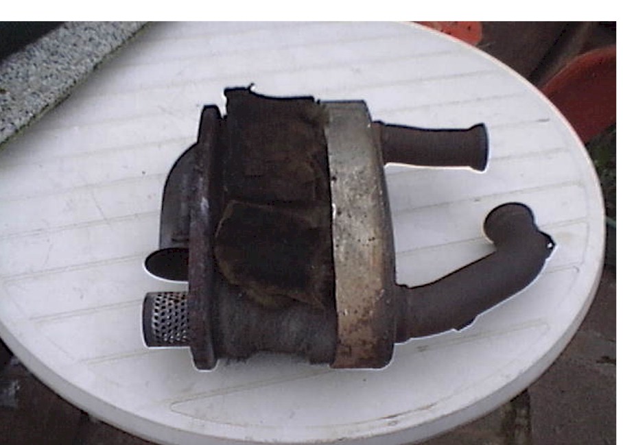

I have seen a photo of a 993 silencer cut open and there is a top and bottom section. The top internal section has a short pipe leading to the exit and the bottom section has more silencing material. So all boxes have a pipe inside. The RSR is known for having some of the inside steel wool/silencer mix cleaned out and it looks very clean on delivery, but after install the boxes are nearly invisible.

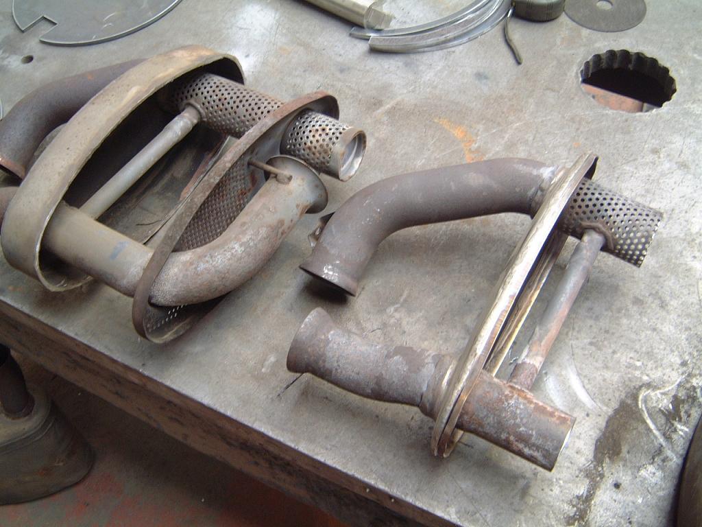

In the picture below, the left hand exhaust is the standard 993 box cut open and the all the wool & wadding removed. The box on the right hand side of the picture shows the internals of a the RSR exhaust.
Graham

In the pic of the standard box there is still a transfer pipe, is this as supplied by porsche? Does the RSR mod entail cutting away part of the internal tubes then, if so do they add some kind of wadding material or does the box remain empty?

Yes Andy, the standard box has the small bore connection pipe - presume just to add a bit of volume? The RSR mod entails slicing through the weld (either using a plasma or slitting wheel) removal of all the internal wadding and then chopping through the two pipes leaving them 100mm long. The box is then re-welded up back together. An additional mod (which I did on mine) was to refit the bellmouth back onto the discharge pipe to reduce the entry losses.
Graham
