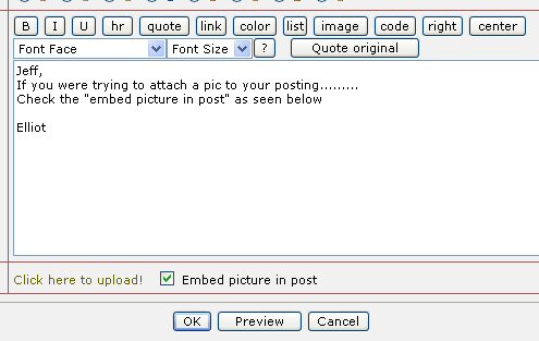

Jeff,
If you were trying to attach a pic to your posting ???.........
Check the "embed picture in post" as seen below making sure that the image is less than 200k
Elliot
