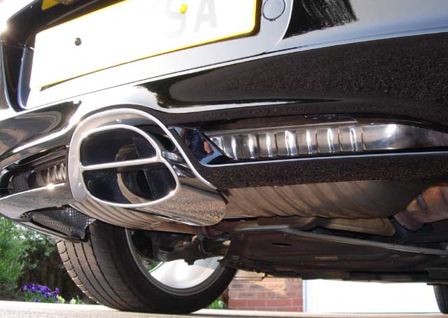

Both the oval and twin pipe trims are stainless steel - wire wool, fine emery or a scotchbrite pad and finally some Autosol will get it back to new. But why have you left it 4 years [:(] ??
You can also get a good result on the silencer box with Autosol and a wire wool - this didn;t take more than an hour from start to finish ...
