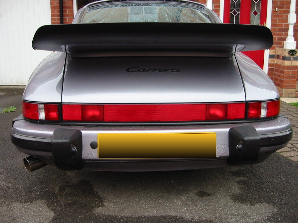

I now have a Hayward and Scott rear box (with the 3in rear tailpipe) fitted to my 3.2. See attached picture. It really does sound as good as WC describes above.
I felt that I had some resonance at around 2600-3000 rpm when I first had it fitted, but after putting some more miles on it, this has now disappeared.
I have it fitted with a standard OE pre-silencer so I don't get the popping noises on the overrun/downshift.

Anil - Thanks for the picture and your experiences. The more I look into this the more I'm convinced that it's the best option.
I need to replace the whole thing as my crossover pipe took a direct hit from some road debris which has squashed it to half its diameter. I'll talk to H & S about the pro's and cons of the sports pre-silencer before getting it done.
