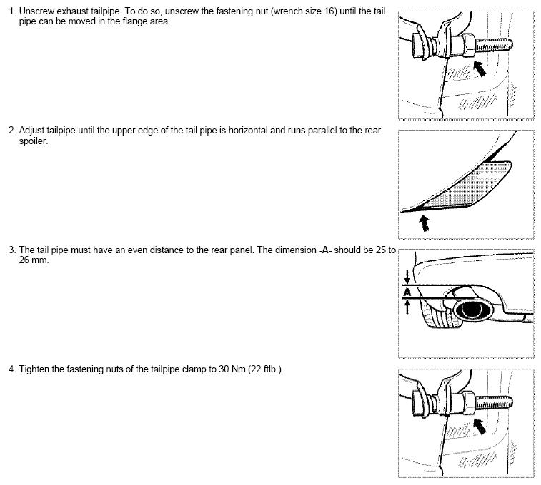

Thanks for the diagram - I saw you posted that before - very good - and also thx for the RMS picture you linked on the other thread - printed it out.. I assume that is a side on view of the rear of the car?

Yes, the RMS pic is taken looking across the car.
