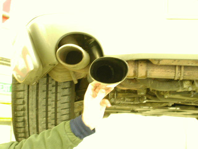

These are the ones - there are 2 versions a short one for pre facelift cars and a long one for post facelift (the rear valance is longer on post facelift cars) but the ovals are the same appearance for both. Had them fited on my '99 C4 and they looked superb. Despite the picture, they are all finished in black / chrome, irrespective of whether they are pre or post facelift.
Ian W

Your original tail pipe clamps will be very rusty, so you'll either have to cut through the bolt, or cut off the bolt head with an angle grinder. Then you'll need some new bolts. If you decide to cut through the clamps then new tail clamps will cost around £7.76 ea (inc discount and VAT).
Fit & tighten your new tips with the clamp and there should be a bolt, toward the rear of the tip (the outward facing end), allowing final adjustment of the tip.
