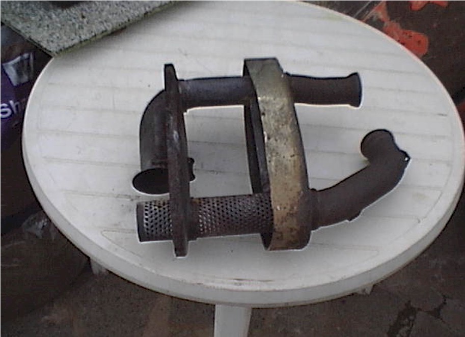

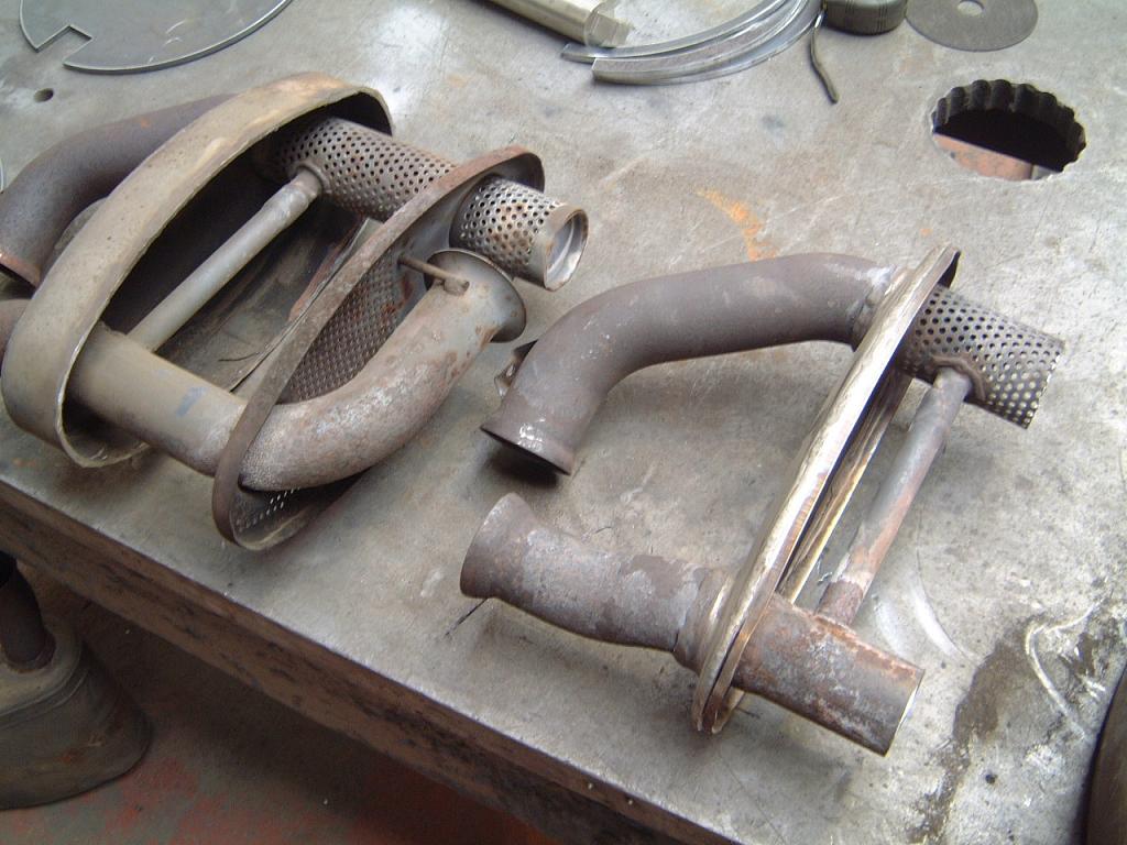

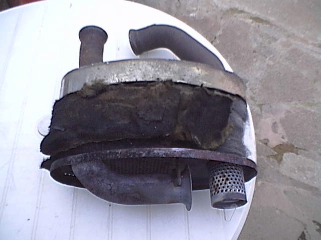

OK so if you use a plasma cutter and open up a standard 993 box this is what you get
Chop off the pipes at 100mm long and TIG weld the cut section back on and hey presto you have an RSR. Easy hey! (If you have a fabrication shop!) I actually reinstated the bellmouth secion which reduces the pressure drop across the entry.
The box weighs probably a third of the original.
