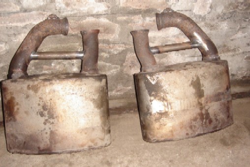

First off I modified a spare pair of silencers by welding a 1.5" diameter pipe between the inlet and outlet - made a great difference outside the car, similar to RSRs but a little louder, not so much difference inside the car.

I've tried to attach a picture of the modified silencers,
