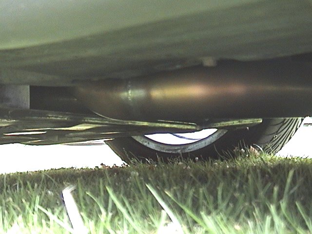

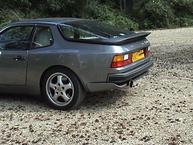

OK it's a rubbish picture, but it's currently on a shelf about 10 feet of the floor, above my car which is on axle stands, so it's as good as you're going to get for a little while from me.
It's a Hayward & Scott full system in stainless. It made a noticeable difference in spool up when I replaced the front section (ie decat) and made the turbo louder. When I then bought the rest of the system it made the turbo louder still,but not much other difference (except my original back box had fallen apart so it was quieter :ROFLMAO: ). Then I got my MAF kit and you can't hear the turbo for induction noise.

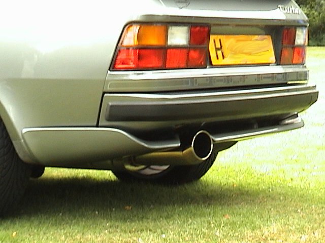

Essential Styling back box - as produced by Janspeed- £270ish from memory. It looks a little less "Max Power" in real life. I think thay also do a car bypass pipe.

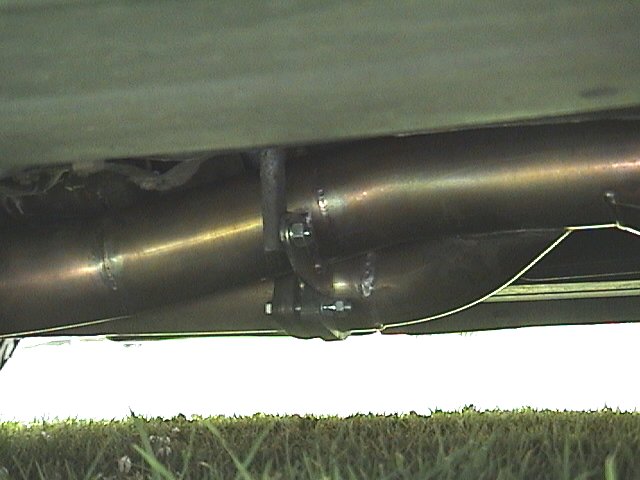

The ESS front de-cat section goes from near the turbo (standard there is a short large bore pipe at the turbo approx 6" long that AFAIK is retained (IIRC with the lambda sensor in it). The other end joins the the rear section at the usual place. In the middle the pipe from the wastegate joins it. I believe the whole thing is larger diameter than the standard pipe, the squared off bit is replaced by a round section. Interestingly Janspeed tried it without a front box first, just straight pipe as Hayward and Scott use (clearly shown in Fen's pic [:D] ) but found no loss of power inserting a front box (roughly where the cat was) and improved sound.

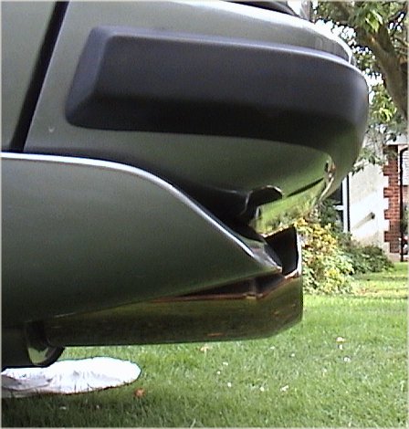

and finally the bit where the pipes come from the engine bay ('squashed' pipe on standard car)
