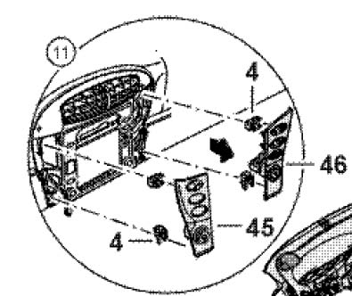

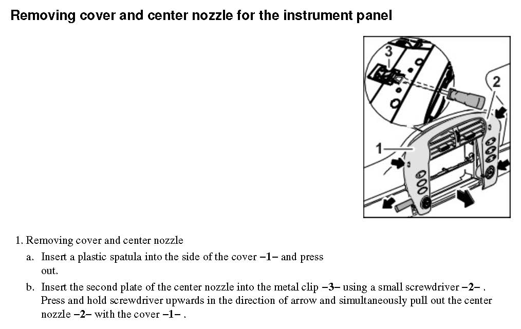

can anyone tell me how to remove the facia panel around the radio ,its the one that houses the switches for the rear window heater ect
thanks in advance
They just unclip. Put a flat-bladed screwdriver under the bottom edge and gently unclip.
i thought it was all one peice the top bit around the vent as well mine is a 986 richard are they diffrent from the 987 mate
thanks for the fast reply
