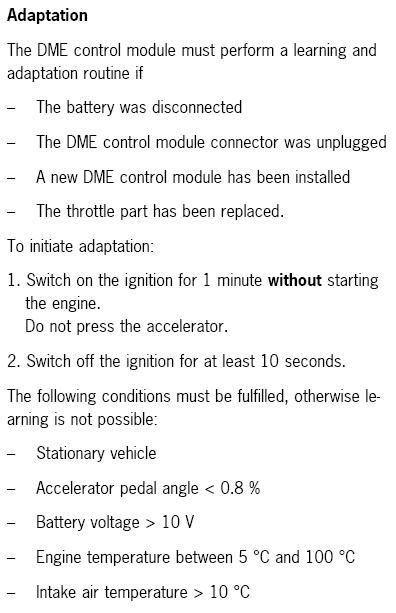

Note on some models , not sure on 996 but definately on 986 when reconnecting the battery you should re-adapt the DME this is partly done by by switching on the igntion for 1 minute then switching of for at least 10 sec then start the car. This allow values to be stored for the throttle adjusting unit.

The procedure you show can be performed at any time but there are other conditions which must be met. This works with all eGas 996's.
I think that disconnecting the battery will reset the adaption values regardless of the other conditions,
That's interesting Richard the conditions aren't listed in the 986 manual(least not in the battery change bit ). Blomin dificult with a battery change in the snow to get temps over 10deg C .[:D]
