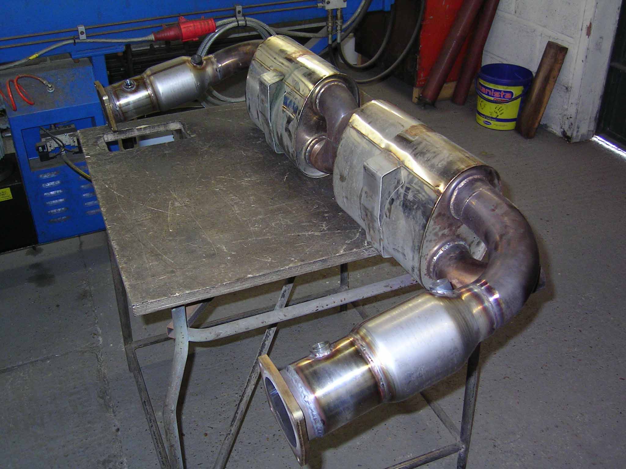

A long-ish saga, but after failing an MoT a couple of weeks ago on CO emissions and various hints and tips from 911UK, used the Durametric to read the error codes and sure enough I had the 'Cat Efficiency below threshold' on both banks. I'd previously cleaned the MAF and had the emissions re-checked with no improvement. I ended up at Zero Exhausts near Ashford in Kent. A real, proper old school engineering concern run by Kevin, who clearly knows exactly what he's doing and is obviously a real perfectionist. Have a look at his website to see some of the stuff he's done. I can't recommend him highly enough. I suspect he'd do a fantastic and inexpensive job of the 'bypass mod' for N/A 996's and 997's. He sourced the right 200 cell, high BHP cats and re-fabricated my existing exhaust - loads cheaper than buying a new one! It fits perfectly and is a work of art. He even rotated the position of the Lambda sensors so they're now easier to access and there's room for the post-cats to have more standoff in case of CEL problems. It actually sounds better than the original and so far so good after 80 miles, no error codes. Here's a picture of the completed exhaust. Now to test the emissions again!

Phew. Looks like the cats were indeed the problem. All sorted now and sailed through the MoT emissions test today.
