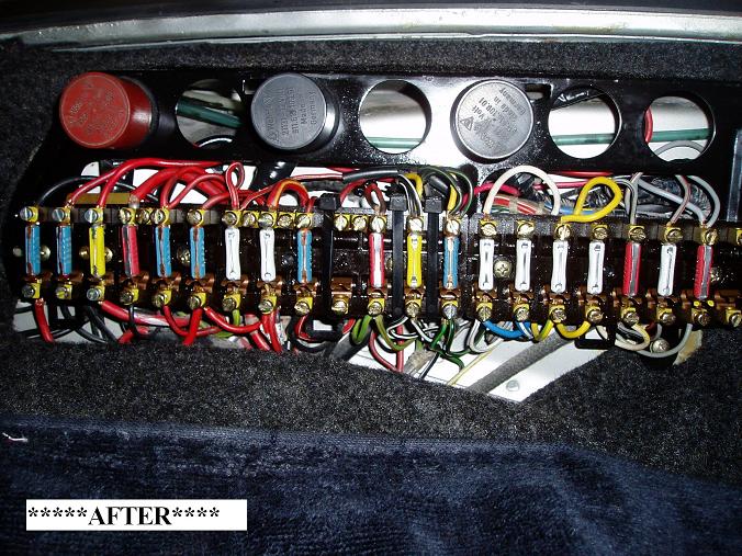

I have attached a picture of my fuse box, I suspect the wires for the fan have been placed elsewhere on another fuse!!! Could you have a look at yours and see what colour wires are used top and bottom of the fuse and the fuse size and I might be able to fathom this out.
Thanks again.
Did all the checks as you suggested John and sure enough, the motor was dead, wiring seems fine dispite missing fuse!! Bought a new motor from PORSHA-PART £39+ vat P&P, fitted it today and works a treat, just as well in this weather, Phew!!
