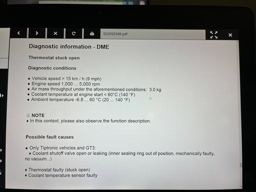

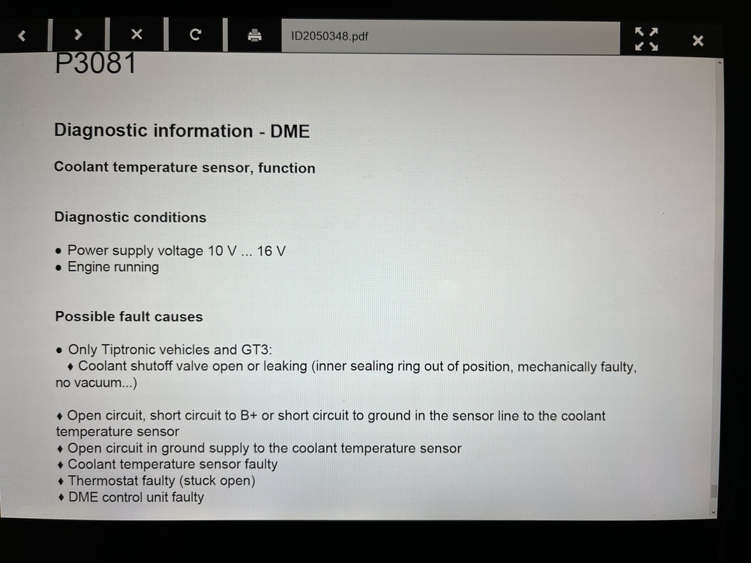

I hope this helps, from PIWIS
P2181
P3081
A couple of common possibles there..
