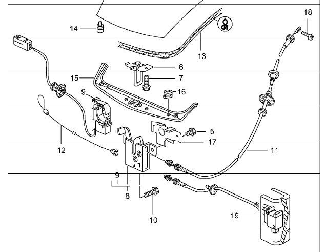

My wife has just got her Boxster back from local indy after small paint job on bonnet but now the bonnet won't spring up. The bonnet release is working but not springing high enough to put your fingers underneath.
Before I take it back and play merry hell, could this be pure coincidence that a spring or latch has broken or come adrift. (the garage says that the bonnet has definately not been removed and they had problems lifting it also).
Is this a small job I can do myself as don't want to let anyone mess about and make it worse?

I can open the bonnet by using something to prise underneath after releasing the catch. I've checked everywhere and can't find anything obvious. It's almost as if there should be a spring to lift the bonnet an inch after releasing the catch. You can hear the release mechanism work ok but the bonnet doesn't spring up that half inch in order to place your fingers underneath to release the manual catch.
John
I would take the plastic cover off (item 15) - two 1/4 turn fasteners (item 16) and look for something obvious. Maybe spray the latch with some WD-40 if the lever is a bit sticky.
