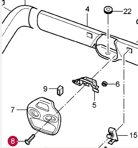

I noticed that when I closed the roof the hook pulled on the interior latch and forced it move so it doesnt sit quite right. It has over the passed few weeks got a lot worse to the stage where now it sometimes "falls" and leaves quite a large gap along the roof/windscreen.

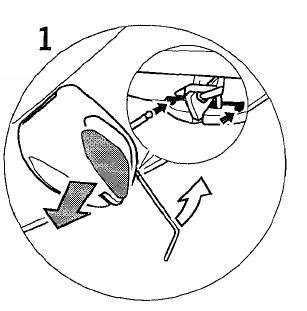

I think I'd be tempted to take off the side covers of the latch housing and poke around to see if anything has come loose. According to the manual, there are holes in the front edge of the housing into which you push an allen key and press the cover down and out.
its not the hook on the roof that is loose, its the internal bit that has the interior lights etc attached to it. The whole thing pulls loose when the hook in the roof pulls on it. Sorry if i didn't make it clear.
Sorted! Cheers Richard. Two torque screws had worked loose found under the covers which just popped off. Feel a bit of a muppet it was that straight forward. Thanks again. David
